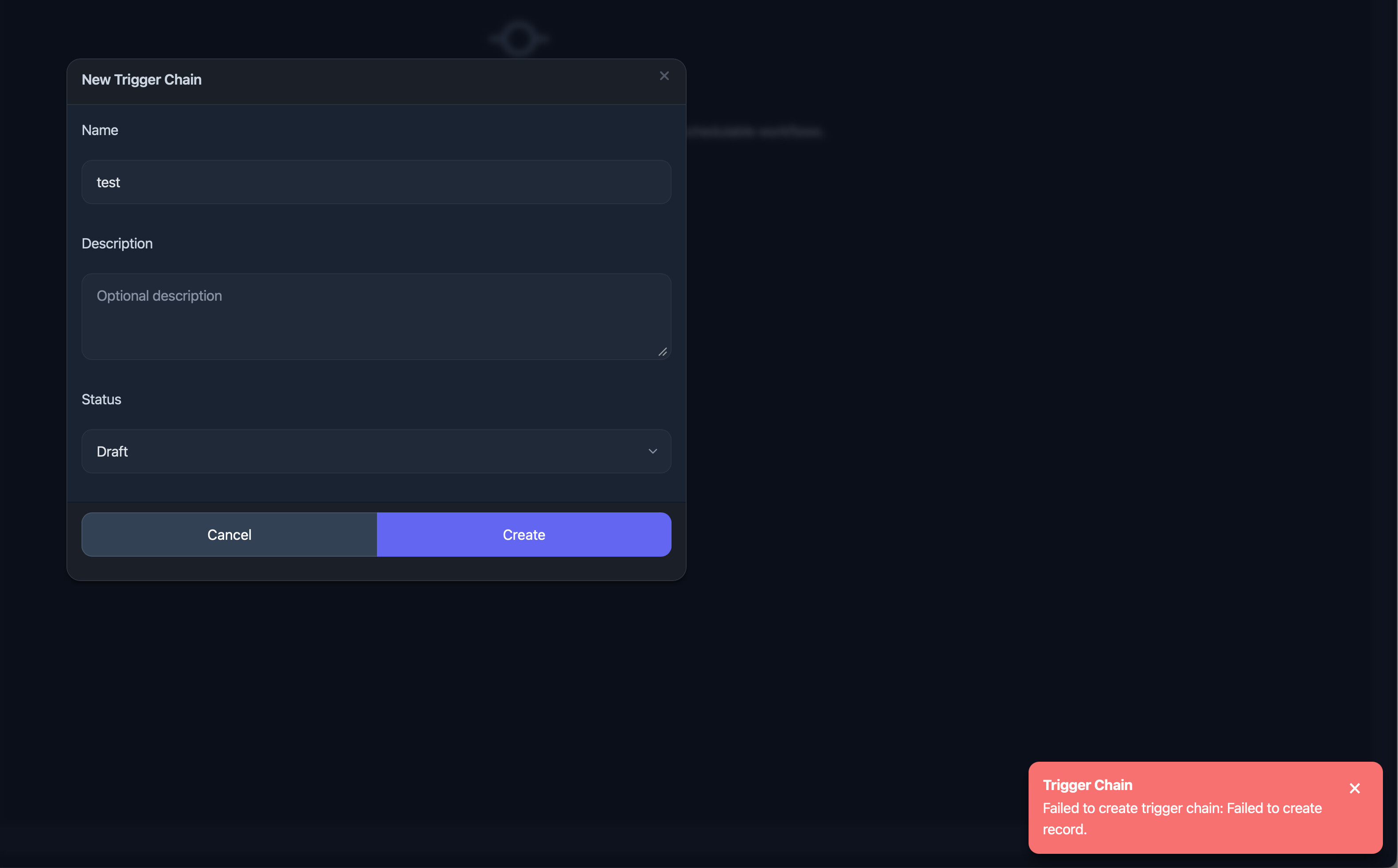

Trigger Chain - Failed to create record
I still have an issue with the trigger tab

This solution does not work. I completely quit RTILA, confirmed that no rtila-database process was still running, and executed all three SQL commands, but the trigger page issue remains. I added some triggers via SQL, I can see it in the interface, but when I want to edit it and save, I have the same error:
Trigger Chain
Failed to update trigger chain: Failed to update
record.
Hi,
Thank you for the SQL cleanup suggestions. I ran all three commands exactly as
described (RTILA fully quit, verified no lingering rtila-database process), but
the trigger page issue remained: chains created via SQL were visible, but any
create/edit from the UI failed with:
Trigger Chain — Failed to create trigger chain: Failed to create record.
Trigger Chain — Failed to update trigger chain: Failed to update record.
I kept digging using the PocketBase request logs, and it turned out there were
TWO separate problems stacked on top of each other. Both are now fixed, and the
Trigger Chain Builder fully works again. Details below, as I believe this
affects other users and your upcoming release.

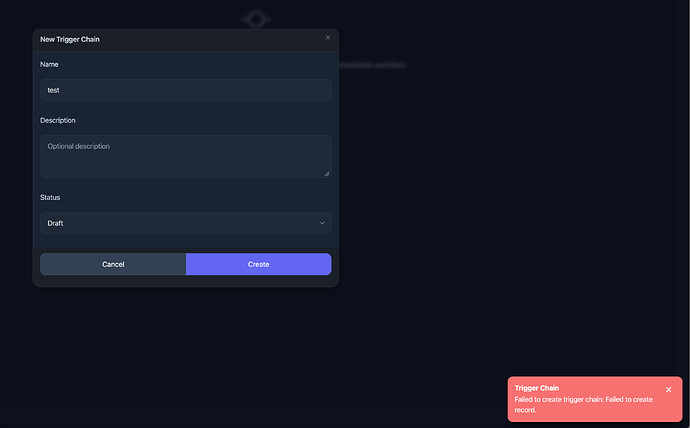

Problem 2 — triggers marked Required in the schema, but the Builder sends it empty
With Problem 1 fixed, every create/update from the Builder was still rejected
with a 400. The PocketBase logs revealed the real reason, which the UI never
displayed:
POST  /api/collections/trigger_chains/records              → 400
details: { "triggers": "cannot be blank" }
error:   "Failed to create record."
PATCH /api/collections/trigger_chains/records/testchain001 → 400
error:   "Failed to update record."
Key facts:
  • Every failing request was properly authenticated (authId ye3yiqst2vx07ks),
    so this was NOT an API-rule problem.
  • A curl create with "triggers": [] succeeded, while the Builder’s own
    request failed → the collection schema marks triggers as Required, but the
    Builder sends an empty/null triggers value when no trigger is configured yet.

The run/runIfDirty/zl frames indicate a crash during a reactive re-render.
During the crash window, the PocketBase logs show no failed requests at all
(no 4xx/5xx) — the failure is purely client-side.
Corrupted data is ruled out: brand-new chain, node saved by the Builder
itself ({“type”: “launch_project”, “params”: {…},
“output_variable_name”: “launch_project_1_queue_id”}), and we even manually
set input_schema/output_schema to {} before testing — the crash persists.
One observation that may help your investigation: after a Builder save, the
stored trigger objects contain no id field (server format: type / params /
output_variable_name). If the Builder’s node delete/modify handlers look up
nodes by id after a save or realtime update, the lookup would fail — which
would match the symptoms exactly (add works, modify saves then crashes,
delete crashes before saving).
Chain-level operations (create chain, edit fields, save) work fine.
Happy to provide full log exports and data dumps if useful.
Thanks!

Hi,
Thank you so much for the kind words — and thank YOU for reading through
everything, acting on it so quickly, and already integrating many of the
previous suggestions into the current version. Seeing feedback turn into
shipped improvements that fast is rare and genuinely appreciated.
I have to be transparent about one thing: most of the heavy debugging was
done with the help of LLMs (GLM 5.2/3 are great). My role was mostly steering the
investigation, running the tests on my machine, and connecting the dots
between the logs and the UI behavior. :slight_smile:
Where things stand on my side
  • Everything is functional: creating/editing chains, adding nodes, and
    deleting/modifying nodes — all changes now save and persist correctly.
  • The only remaining item is the cosmetic UI crash dialog after each node
    delete/modify (the frontend re-render issue we discussed). I have to quit rtila and reopen it.
  • As a durable local guard (since custom hook files can’t survive the hooks
    purge — which I now understand is by design), I installed two SQLite
    triggers directly in data.db (trg_tc_norm_ins / trg_tc_norm_upd) that
    coerce any null/blank triggers, retry_policy, input_schema and
    output_schema to / {} on every write. They survive restarts and are
    invisible to the app. I’ll remove them as soon as your fixed version
    ships, so I can validate your fix cleanly.
One small suggestion for the upcoming release
If possible, ship a tiny data migration alongside the code fix, to normalize
records that already contain nulls — users who hit this bug before the fix
will still have corrupted records stored (the code fix prevents new ones,
but won’t repair existing ones).
One feature request
Would it be possible to add an export option for records in PocketBase (CSV and/or JSON)
in the admin dashboard, similar to the existing log export? Being able to
export any collection’s records would help a lot for backups, external
analysis and support workflows. Honestly, the log export feature is what
made this whole investigation possible — having the same for records (e.g.,
trigger_chains) would be a fantastic addition.
I’m really looking forward to the next update. This software has enormous
potential compared to every other automation tool I’ve tried, and I genuinely
enjoy using it for my projects. When the new version lands, I’ll gladly test
both fixes and confirm.
Thanks again for building such a responsive, high-quality product!
Best,
Alexandre-Kamel
Update 8.3.213 is now live and resolves the issues reported above. Could you please confirm if this update fixes the issue for you? Thank you for your feedback and support!
The triggers don’t have any crashes in saved/edited it, but I will test it more later. But I notice the JSON still has some “null”. May be an issue but not sure.
