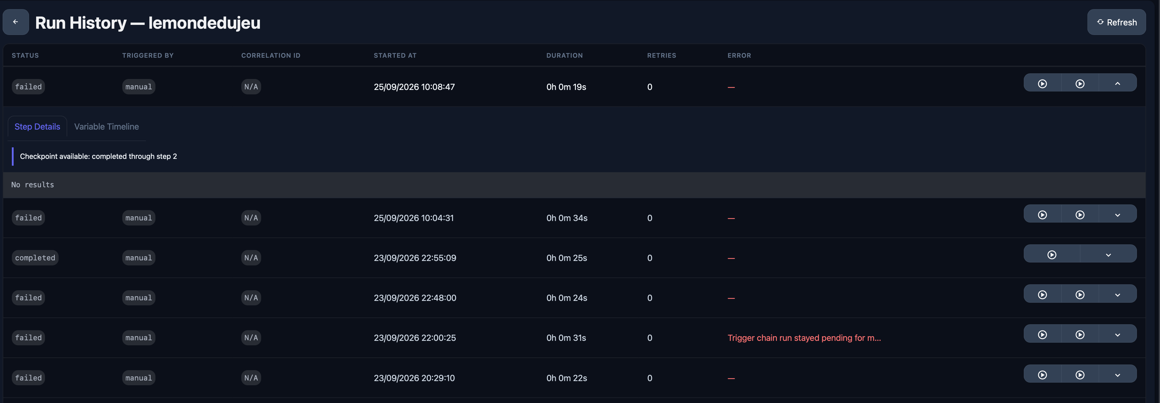

The second issue is that when an automation has been started and I stop it manually, the trigger treats the action as a failure. Alternatively, I may have configured something incorrectly.

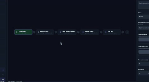

Here’s my current trigger chain (3 steps):
Step Type output_variable_name Notes
0 launch_project launch_project_3_queue_id wait_for_completion: true
1 read_project_dataset read_project_dataset_2_records Reads 307 records with fields url and page_source
2 google_sheets google_sheets_3_cell_value Operation: append_row — this step fails
Steps 0 and 1 work perfectly. The project runs to completion, and read_project_dataset returns 307 records. I can see the data in the run record — URLs and page sources are all there.
Step 2 (Google Sheets) fails every time.

I notice also, in read project, Dataset name is not saved when I edit the workflow.
Watch Video
and also, rest api, no data are saved
