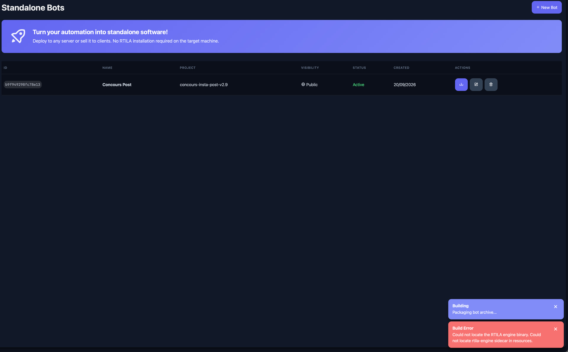

I have an issue when I tried to export a bot
It happened when I changed the path of export to desktop.
I didn’t see what was the original path to test it.

Hi,
New issue: the standalone export fails (RTILA 8.3.213, macOS 26.6.1, Apple
Silicon arm64). Export destination: Desktop — not the cause, the failure
happens during packaging, before any file is created.
Error:
Building
Packaging bot archive...
Build Error
Could not locate the RTILA engine binary. Could not locate rtila-engine
sidecar in resources.

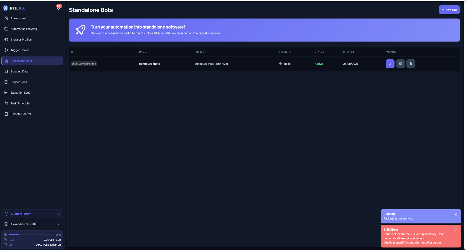

Version 8.3.214 is live now and it includes a fix for the issue reported on Mac. Could you give it a try and let us know if everything looks good on your end? Thanks again for your help and your support!
New version didn’t solve this issue. new error message:
