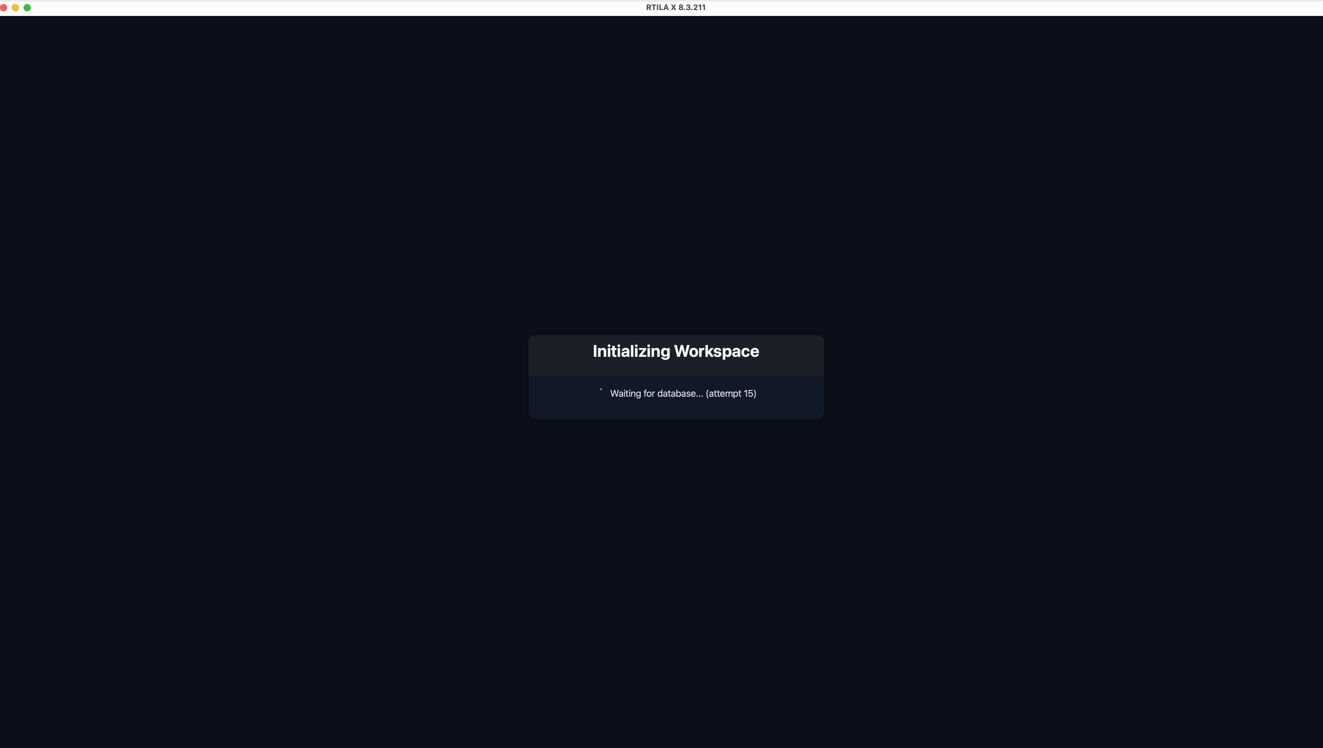

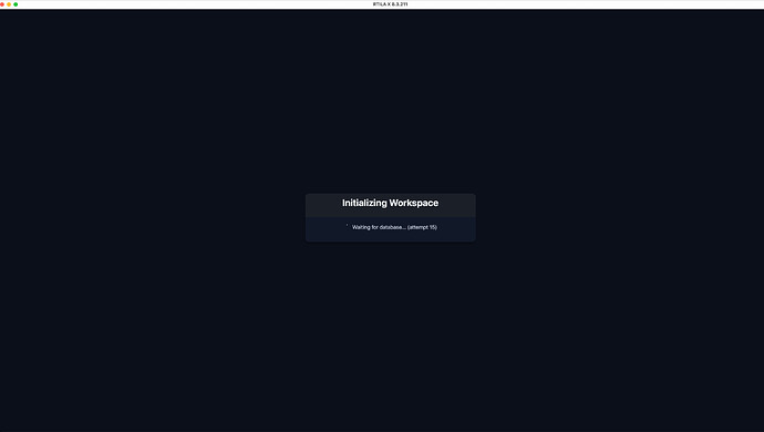

Hello, I update macOS to Tahoe 26.6.1. and now I have an issue:
" An error occurred during initialization: Database sidecar failed to start in time."
Even with old versions of rtila, I have this same error of initialization of the database.

Issue 1: PocketBase panic — duplicate route registration
After running RTILA from the terminal (/Applications/RTILA.app/Contents/MacOS/rtila-x), I discovered that the database sidecar (PocketBase) was crashing on startup with the following panic:
panic: pattern "POST /api/remote" (registered at router.go:130) conflicts with pattern "POST /api/remote"
Root cause: Two hook files in ~/.rtila-x/database/hooks/ were registering the same route POST /api/remote:
  • remote.pb.js (2,846 bytes, created at 20:27, no @ extended attribute)
  • remote_execution.pb.js (7,944 bytes, created at 21:04, with @ extended attribute)
It appears that during a recent RTILA update, the new remote_execution.pb.js was added but the old remote.pb.js was not removed, causing a duplicate route registration and a PocketBase panic on startup.
Fix: Renamed remote.pb.js to remote.pb.js.bak to prevent it from loading, keeping only remote_execution.pb.js active.
Issue 2: Permission denied (os error 13)
After fixing the duplicate route issue, RTILA progressed further but hit a “Permission denied (os error 13)” error when trying to access the database files.
Root cause: macOS Tahoe appears to have reset or restricted file permissions on the ~/.rtila-x/ directory during the OS update.
Fix:
bash
sudo chown -R $(whoami):staff ~/.rtila-x/
sudo chmod -R 755 ~/.rtila-x/
chmod 644 ~/.rtila-x/database/data/*.db
chmod 644 ~/.rtila-x/database/.db_key
chmod 644 ~/.rtila-x/database/hooks/*.pb.js
chmod 644 ~/.rtila-x/database/hooks/*.js
xattr -cr ~/.rtila-x/

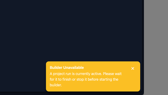

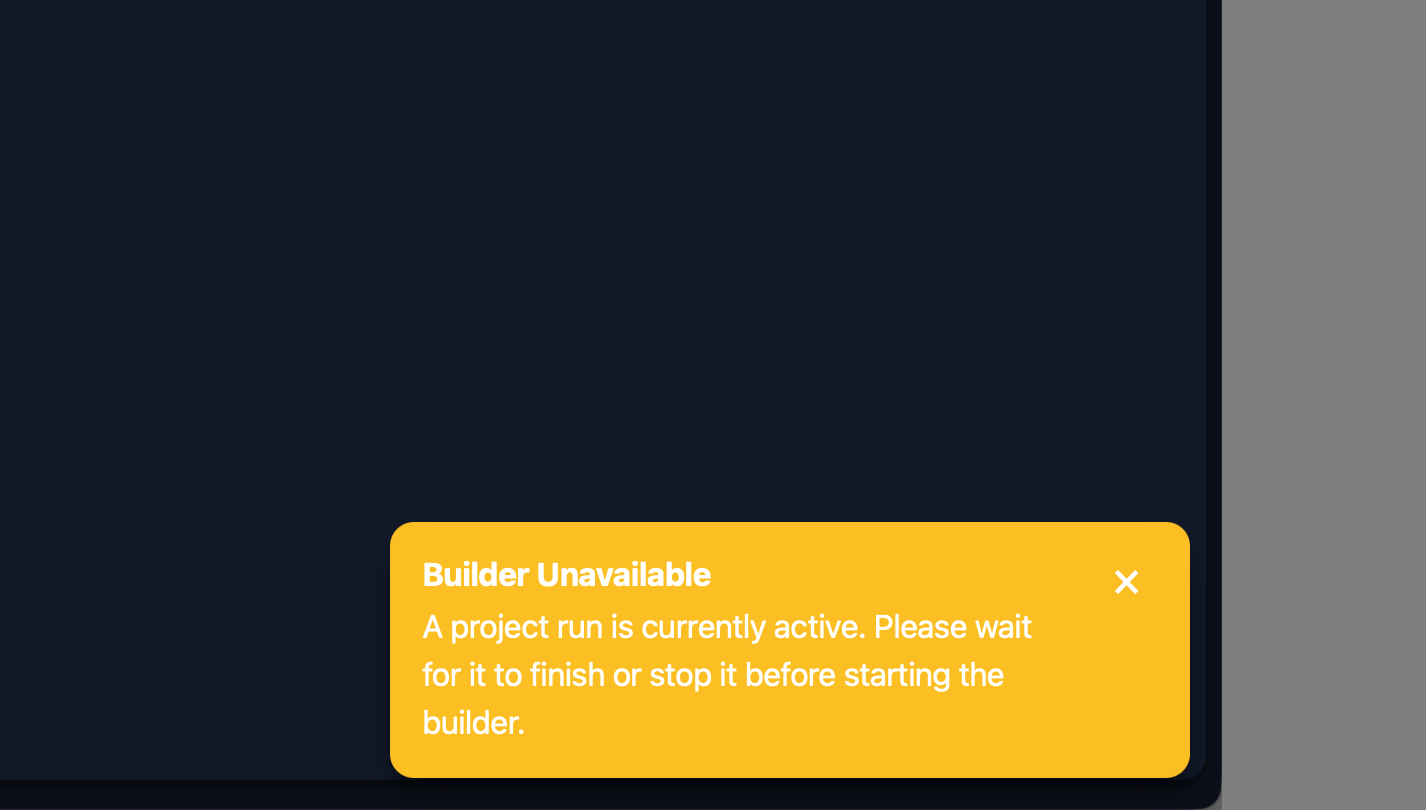

Issue 3: “Builder Unavailable — A project run is currently active”
After RTILA launched successfully, In Browser Profiles, When trying to run a profile, the Builder was locked with the message “A project run is currently active” even though nothing was running. This was caused by stale run states left in the database from the previous crashes.
Fix:
bash
sqlite3 ~/.rtila-x/database/data/data.db "UPDATE trigger_chain_runs SET status = 'stopped' WHERE status = 'running' OR status = 'active';"
sqlite3 ~/.rtila-x/database/data/data.db "UPDATE queue SET status = 'stopped' WHERE status = 'running' OR status = 'pending';"
